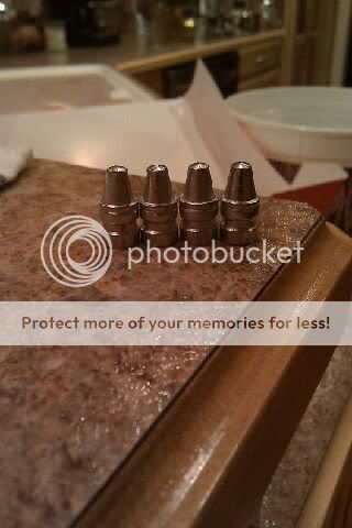

Post by Beladran on Wed Jan 12, 2011 8:02 pm
ok its show and tell time!
this pile was done in about an hour. they are averaging in weight at 147gr and size at .359.. o and believe it or not but i actually had to start using that lead hammer i made lol and sometimes it would take two or three wacks.

Post by SubGunFan on Wed Jan 12, 2011 8:39 pm
Nice and shiney.......... Those look GOOD ! ! !

Post by Beladran on Thu Jan 13, 2011 7:39 am
i frosted a few sets on accident.. forgot to turn pot off of high. I like how the sprue is designed with the valley in it. with my lyman's you gotta put the cavity hole right under the dispensing hole on your pot. Pour, stop, move to next hole... with this mold once it gets good and warm put it on the center hole and fill the whole thing up and it works like a ice tray filling each cavity..

Re: hensley and gibbs
Post by Doug Bowser on Thu Jan 13, 2011 1:21 pm
The cavity fills more efficiently, if you pour the lead into the center of the hole above each cavity and move the mould backward . I start and stop the lead flow over each hole in the sprue cutter. Also, use 2 moulds and you will never get frosted bullets.
Post by SubGunFan on Thu Jan 13, 2011 5:35 pm
I start at the back hole (farthest from you) and with one continous pour steady push the mold forward. This only works well if you have a mold guide on the pot. The mold guide takes the weight of the mold off of you and holds the mold at a constant distance from the spout.
Flow rate is important with this method. As the pot gets lower I adjust the flow rate screw.
