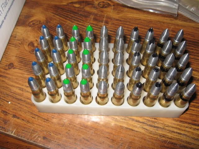

Yesterday, while sitting here watching it rain, I remembered the AK shoot scheduled for next Saturday after the Carbine match. Looked and I was fresh out of cast AK rounds!! Looked at my cast boolit stash and only found a handfull!! Looked for my loading data for the boolits and have yet to find it ... so back to the drawing board ...
Loaded up 50 today using 5 different loads ...

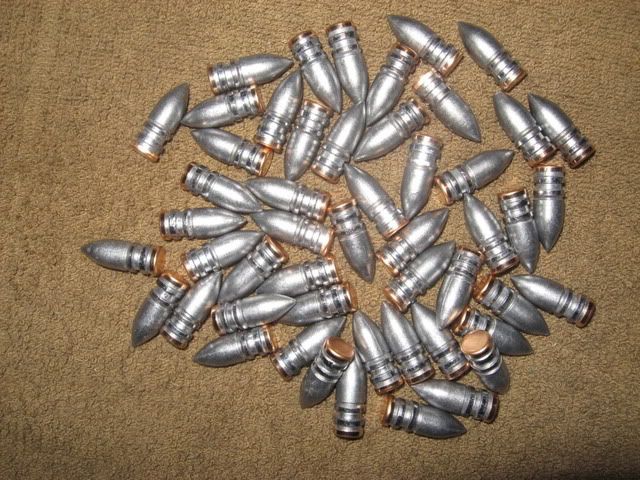

These were cast at .3145 - .315 ... used my Lee sizing die to size down to .314 and seat the gaschecks ...
... then ran them through the RCBS lube-sizer and took them on down to .313 and added the lube (used 50/50 on them) ..
If it is not raining too much tomorrow, going to the range and test them at 100yrds --

Darn good looking reloads Cap'n

Dang Captain....... your ammo looks too good and is so darn organized.....
WRITE the winning load down and put it in your safe....... Smile

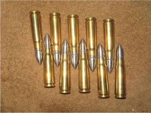

Do you use normal 30cal GCs, or do you have to buy oversized 30cal GCs for .313 bullets?

lol ok wait a minute. you got incendary, armor peircing, ball, and tracer boolits???

Bel, Captain doesn't tell all his casting secrets................

those come from a hoch mold?

SubGunFan wrote:Do you use normal 30cal GCs, or do you have to buy oversized 30cal GCs for .313 bullets? .
The shanks are cut for regular .30cal GCs ..
Beladran wrote:those come from a hoch mold?
NOE Mould ...
