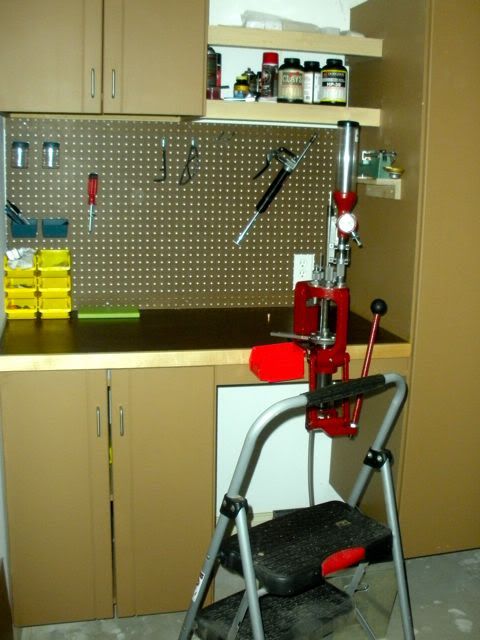

The only recommendation I could make is use wall hung cabinets with a counter-top for the bench. I made my top out of 2 layers of 3/4" MDF and 1/4" hardboard laminated. Put 2 or 3 coats of poly to seal it. It's solid with zero movement. You might also consider running T-Track in the counter so you can move things around without having to drill new holes.
I've also installed extra lighting under the top cabinets. Plenty of storage and works well for my small room. For 11x12 you can run a much longer counter. I have 12' running in my garage with a flip up work bench.

The bench is important and the light is too. If you use a digital scale and powder suspensor, make sure it has a own place where the moves of the reloading press has no influence on it. And lot of place under the bench for brass and if possible a window for fresh air if you cast your bullets. All other things are have to fit to your purposes.

Post by RStewart on Mon Jan 02, 2012 2:55 pm
It ain't fancy, but it is functional. And cheap!
Workbench
Loading Bench

Post by RStewart on Mon Jan 02, 2012 3:42 pm
One last one of the rest of my setup. Yeah, I'm cheap, but it all works.

The bench is the heart of the operation. I built mine onto the wall using 2 x 4's lag bolted to the wall and have a support every 4 feet. Visualize where you want your presses and make sure there is a solid support under the bench directly under the press. The same for your powder weighing area. This minimizes the vibrations caused by using the presses at the same time you're trying to accurately weigh powder if someone else is working in your reloading area at the same time you're trying to weigh powder. Build good cabinets above the workbench. It's not necessary to have doors on the cabinets. Mount hanging 2-bulb flour. light fixtures over all work areas, keeping the one above the powder weighing area at least 3 1/2 feet above the bench to prevent interference with your powder scales, if you use electronic scales like I do. I try to mount my presses over some type of steel plate to minimumize the "give" of the workbench when using the presses.
