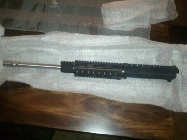

Post by BigDaddyQ on Sat Mar 03, 2012 10:13 pm
My friend has killed many deer and other furry woodland creatures with his whisper. He has a integrated suppressed barreled 300whisper bolt gun. As an experiment he shot a whole box of blackouts he bought from the store through it and had no problems. I got a SOTA arms blackout upper in the mail friday afternoon. I have not picked out optics yet but am pretty sure I'm going with a sightmark night rader night vision scope. I will be purchasing a DPR can as soon as they are available and start waiting for form 4. I fired one at Necks suppressor shoot and I can say it is very quiet and cycled off the shelf SS ammo. As far as its ballistics you only get so much uhmp and still get subsonic. If you are buying it for a supersonic round you are wasting your money. It will shoot supersonic but there are much better performers out there.
so my pro cons list is
pro
cycles ARs subsonic
easy to make ammo from 223
factory loads available at vans sub and super
uses existing 223 mags
is 30 cal so can use can on multiple guns
also have several 30 cal bullets laying around
less case void space
fairly accurate
cons
limited supersonic capabilities
if not going with AR lower there are better subsonic options ie bigger calibers
here is mine I think its purdy.

Post by Joe S. on Sat Mar 03, 2012 10:23 pm
It is purdy
