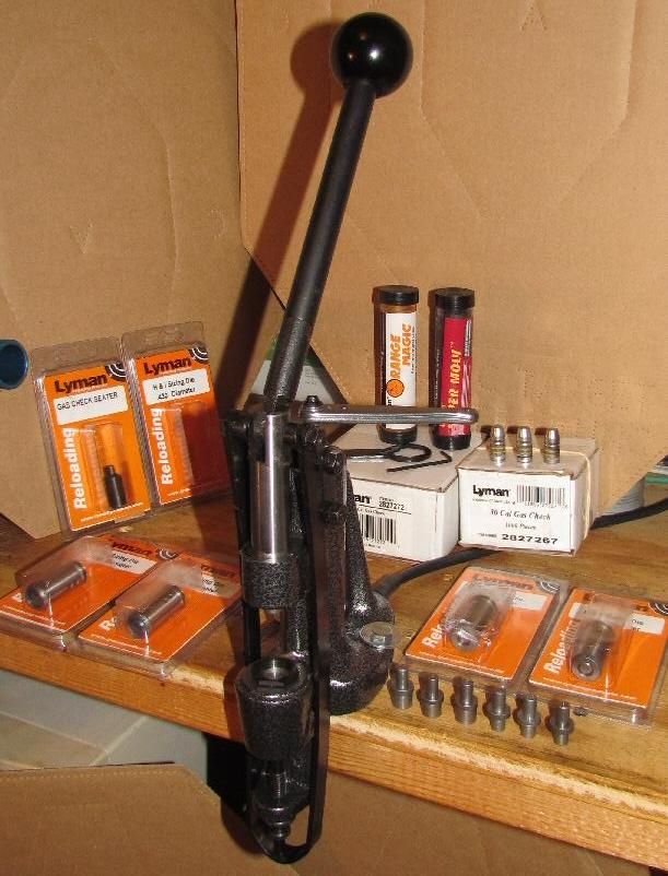

I have been shopping on Amazon for the past 2 weeks gathering all this stuff.  So tonight I decided to mount the sizer so I can work with it this weekend.
Around the 1st of June I used M1GF's 4500 to size & lube some 30cal bullets, and got HOOKED.  Yes, I have 3 Star lube-sizers, but going back to the basics and wanting to cast more rifle bullets appealed to me.  True, the Lyman and RCBS sizers are slower, but they can do more (ie: gaschecks) and are faster (and cheaper) to change dies and adjust.  I had an RCBS sizer many many years ago when I started casting.  But trying to feed my competition handguns and SMGs, that RCBS sizer and 2 & 4 cavity molds didn't cut it.  That was when I upgraded to a Star sizer and gang molds.
Tonight I used some of Bel's 335gr 44cal bullets to setup the 4500.  The first bullet got stuck in the die and I had to remove the die and hammer that bullet out.  But I did that before any lube reached the die which was MY BAD.....  The first lubed bullet had black oil mixed with the lube in one groove, but that was from the protective oil Lyman puts in the sizers.  All other bullets so far are looking GOOD.  Tomorrow I will sizer a bunch more.
Also in my Amazon shopping, I picked up 2 LEE molds.  One is a 2C 450gr 45-70 bullet and one is a 2C 175gr 8mm bullet w/ gascheck.  Captain, if you are reading this post..... do 30cal gaschecks work with 8mm bullets?  I know 30cal gaschecks are good for .312 bullets, but what about .323 bullets?
And still pending (but shipped today) from Amazon....  I ordered a LEE 6C 310gr 44cal w/ gascheck mold.  When ordered last week, the Amazon ad stated 3-5 weeks to ship.  I didn't mind because I wanted that 6C mold.  The "shipping" text message this morning was good news.

That mold by far is my favorite mold that Lee puts out. I love my Lyman 4500 as well. I still need to order the heating element as mine didn't come with one, been using the wife's hair dryer to get the lube flowing. Great looking set-up you will be amazed at the amount of top punches you will accumulate.

Oh and I hope you haven't used the Super Moly tube of lube that is some messy stuff.

cranedriver wrote:Oh and I hope you haven't used the Super Moly tube of lube that is some messy stuff.
No, because I opened and looked at it and it was a SOFT lube.  That stick of moly came with the 4500.  The Lyman Orange Magic is a hard lube that requires heat.  I would have used some of my Rooster or Thompson or other hard lubes, but they are all solid sticks used in Stars.  I need to start shopping for good lubes in hollow sticks.............. Smile

I use caranuba red in the hollow sticks, no worries if you have a stock pile of solid sticks you can melt them and pour them into the Lyman and let cool works just fine.

cranedriver wrote:I use caranuba red in the hollow sticks, no worries if you have a stock pile of solid sticks you can melt them and pour them into the Lyman and let cool works just fine.
I might try that as I have a bunch of solid sticks of the good stuff. Or find a hollow stick mold setup so I can make multiple sticks.

You may want to look into getting a flat nose punch as it can be used on just about any handgun round. One nose punch works on all my bullets, plus it helps by allowing the bullet to slide into alignment once the ram develops slop.
http://www.msgunowners.com/t26442-the-problem-with-a-lyman-4500-mine-at-least
Also, sizing in a Lee push through helps as well

SubGunFan - Looks good....like you I progressed through several lub-sizers and ended up with the Lyman- I had 2 of them and have sold one.  The old one I have is Lyman orange.  Something you may (most likely will) consider in the future is the little warmer plate that mounts under the lube sizer......a great addition.

CottonDoc, I bought the version of 4500 that includes an internal heater (see black wire running out of the base).  However, the heater is ALL on or off, so you have unplug it when the unit gets too warm.  A variable control like the Stars would be nice..........  The heating unit looks like a blasting cap and goes into a hole in the base.  It does a good job of heating the unit.

Just shows you how out of touch I am -- LOL.  mine is a plate that mounts between the sizer and the bench.  The warmer really comes in handy with the use of the magnum type red and blue lubes.  I generally do not like to"size" bullets - just use a sizer die that the as cast bullets slide into and forces the lube in the groves smoothly.
For my heavy 45 cal bullets (470 to 500 grain) I use in black powder cartridge rifles,  I pan lube.  The bullets for black powder are relatively soft and a squeezer-greaser can distort them very easily.  For those I either use SPG lube or my 1:1 mixture of  beeswax : avocado oil applied by pan lube method.
I was surprised when you said your  Sharps clone would not let you seat the bullets long.  generally Sharps and Sharps clones have a long throat as black powder bullets are generally big and have to be seated out to allow space for powder.

I wonder if a dimmer switch would control the heat.

I don't think a dimmer switch is the way to go.  My RCBS pots and Star heating elements all use a thermostat to turn the units FULL on or off.

Dan, something like this should work ... http://www.amazon.com/Camco-07733-Extended-Heater-Thermostat/dp/B000BQUJ54/ref=sr_1_13?ie=UTF8&qid=1378776637&sr=8-13&keywords=water+heater+thermostat

Rw wrote:Dan, something like this should work ... http://www.amazon.com/Camco-07733-Extended-Heater-Thermostat/dp/B000BQUJ54/ref=sr_1_13?ie=UTF8&qid=1378776637&sr=8-13&keywords=water+heater+thermostat
But where does the sensor probe go....?  I can't tell if that unit includes a probe.

Its just a rheostat, there is no sensor. Just adjust it by "feel".
I think home depot may have one with a sensor, seem to remember some kind of kit back in plumbing from my days there.

That's a flat surface mount Thermostat like on some electric water heaters. The sensor is on the back, feels the cooler water of the tank to turn the element on.

First, the 8mm bullet project.  This one is on HOLD for now.  The reason being is I can't get the Lyman 4500 gas check seater do-dad to work.  It will not allow the bullet to go deep enough to seat the check.  I tried both 8mm and 44cal bullets.  Today I ordered a LEE .323 push-through sizer to seat checks.  I can take the do-dad off and seat checks, but there is not enough resistance to ensure the checks is seated square.
Second, the 44cal bullet project.  Since I do have a LEE .430 push-through sizer, tonight I checked, sized and lubed 40 LEE 310gr 44cal bullets.  Ready to go they weigh 305gr.  Not as big as Bel's big bad boys, but I have a 6C mold to make them..... Smile  Tonight I loaded the 40 bullets with 15.5gr of 2400.  Tonight was the first time I have loaded 44 Mag on a single-stage press in a LONG time (decades).  It was FUN...... Smile

Just put the sizing die in the unit .... place the gascheck into the sizing die ... place unsized boolit on top of gascheck ... size boolit!! Gas check should be seated ...... Never never used a gas check seater ....
